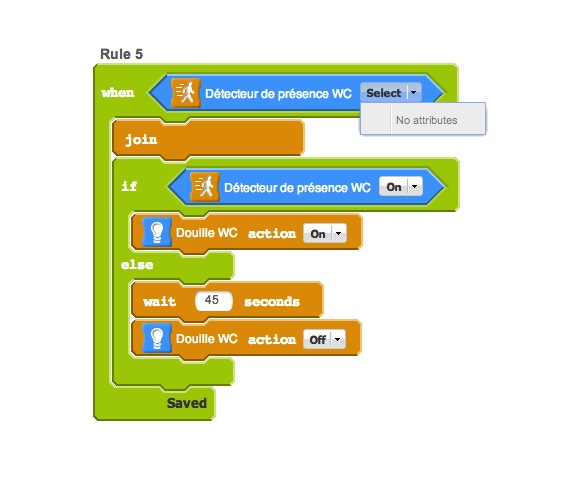

Hello, I have a motion sensor everspring SP814 which I added as generic zwave but I don't know how to use it in my rule.
In the when puzzle, if I add a "sensor" sensor and then I put the sensor everspring the select doesn't offer me any choice and I can't save the rule, is it normal?
Ok I think I found the way to do it by putting a "control" in the when puzzle and the testing the toggle value
