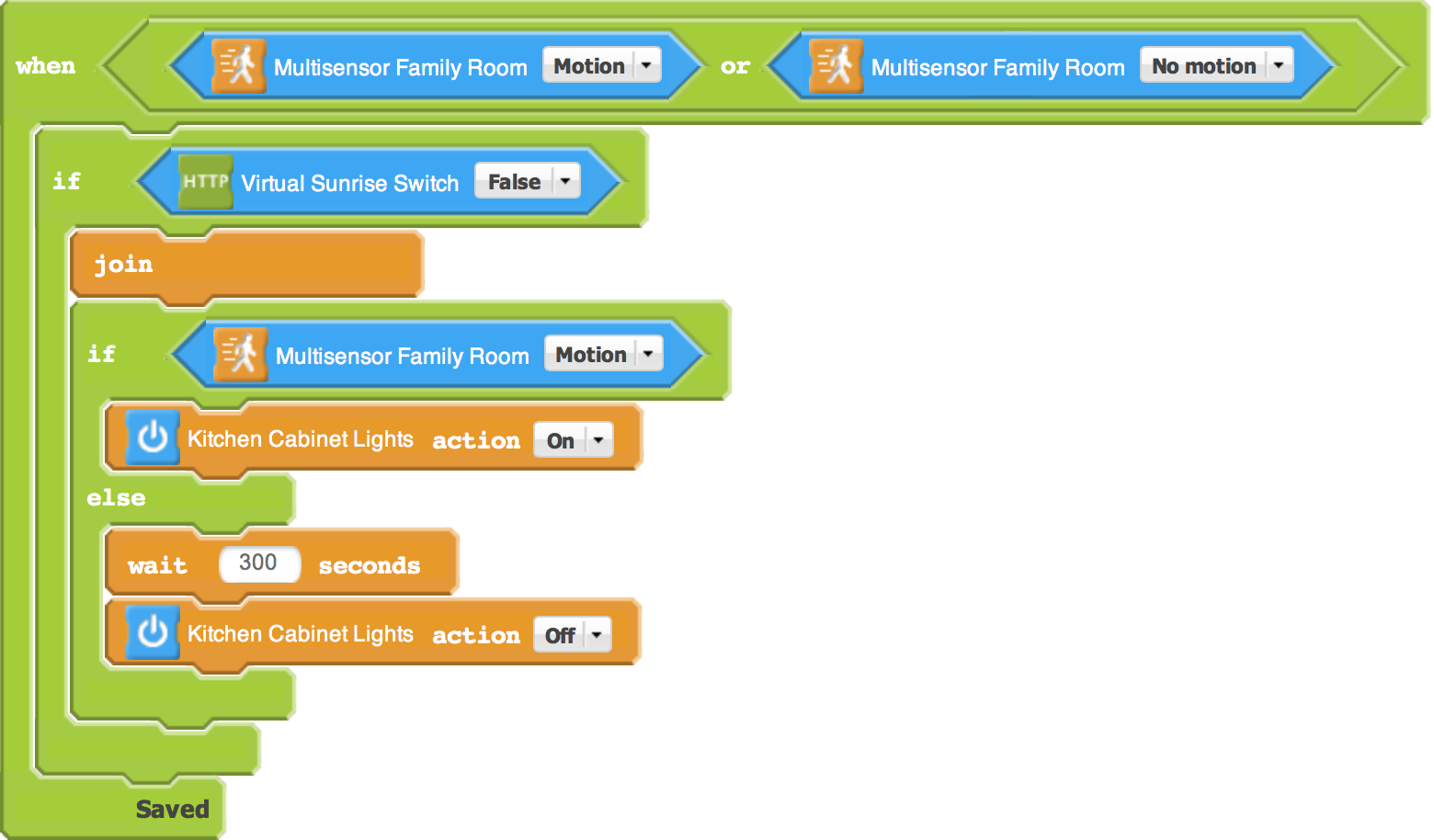

My box had to be brought to factory default, so I end-up recreating all my rules.
One of them, uses virtual sensor bind to virtual switch which toggle depending on sunset/sunrise. It all looks good, I can see that sensor toggles and then switch changes as well. My rule uses motion detector (multi sensor, so I had to use motion on or motion off to avoid triggering by temp/humidity changes) as a trigger and then checks if we are past sunset (switch off/false) and turns the lights on. THIS USED TO WORK before the factory default. It does not work anymore, basically the motion detector triggers the rule despite virtual switch being false (during a day). Please see the actual rule attached. I used sensor puzzle and actuator of virtual switch.

confirmed that Refresh All did not help, it works but state is reversed
