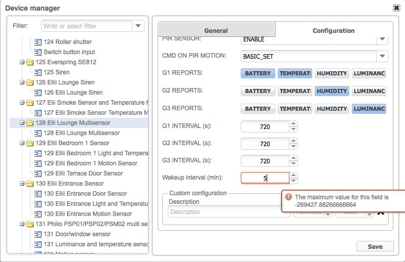

I cannot save any settings as the wakeup-interval says its maximum value is a large negative number. This is with firmware 0.9.995, I was getting NO_MOTION every minute with 0.9.994 (all with an Aeon Multisensor which worked in the past)

I am running 0.9.998 and I can't set the wake up interval on my multisensor. I have tried to re-apply device descriptors. See attached picture. No vaule I enter gets accepted.
Any comments, Zipato?
