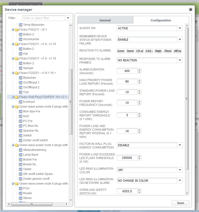

I put my Wall Plug on my
fridge yesterday (it was on my comps) to monitor if the door is open. I had to
remove it from the dashboard and added it again because it was offline.
But now there is a problem
that the wall plug turns off (without me touching the button on top).
Is there something wrong
with the config?

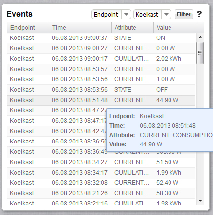

I noticed the same behavour upon turning off the always-on device on dash board.
Then a off statement is reported in the event log and since always on a few min later it's reported as on.
It seems like the device is always on anyway. So the behavour seems incorrect in the log.

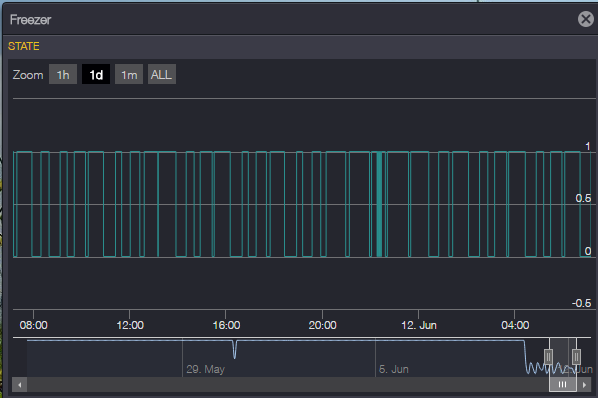

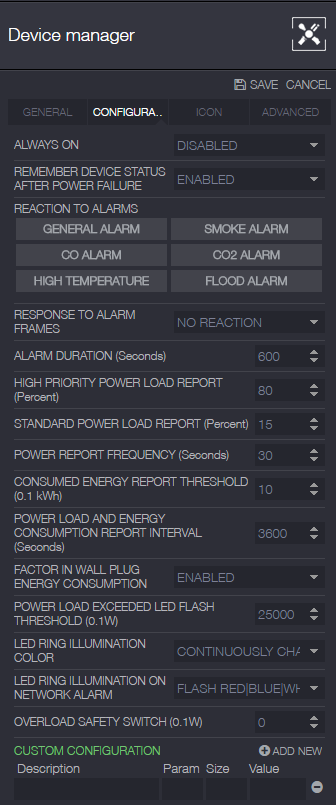

Hi.
I have similar problem.
I've tested three different wall plug`s which are working with other devices .... only not with freezer.
I constantly seeing that switch is switching on & off, but the freezer works always.
Also with settings > ALWAYS ON (enabled).
Is this ZIPATO issue ????
Some pictures are attached.
tnx again.
