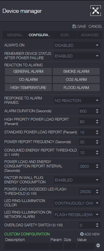

I've tested three different wall plug`s which are working with other devices .... only not with freezer.

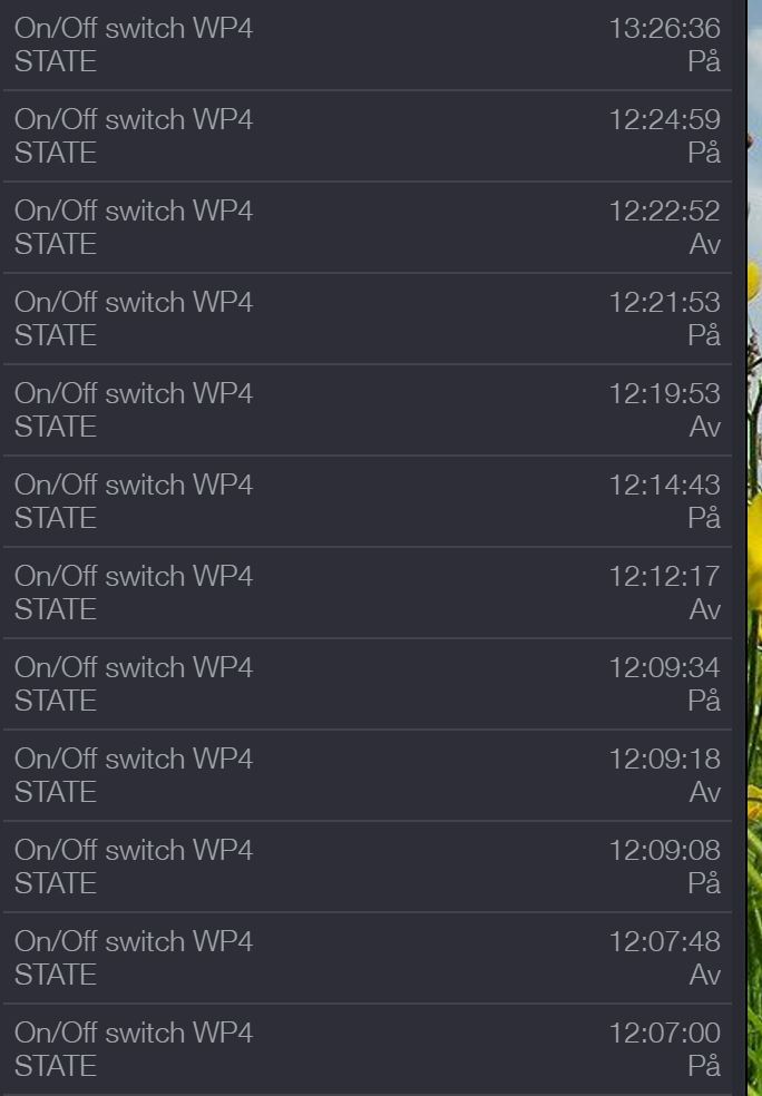

I constantly seeing that switch is switching on & off, but the freezer works always.
Also did try with settings > ALWAYS ON (enabled).
tnx again.

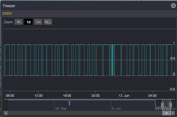

I have connected freezer to another wall plug from refrigerator.
In a day or 24 hours the freezer has switched state to off about 40 times (on another plug) !!!
Refrigerator which was connect to a plug from freezer, has changed the state two times in 24 hours.
Hmmm, strange the least. Do you have reported metering values? It looks like it is definitely something with your fridge.
