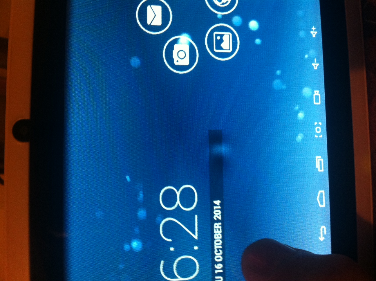

I have bought a new wall zipato tablet, but i'm surprises by the bad screen's quality
Right, when i touche the screen like my ipad , screen seems to be deformed like old screen 10 Years ago!

As U can see on the attached pic, when U touch one corner of tab, there is something happen on middle of the screen.
is-it normal?

Hi everybody, I have 2 of them and have the same issue on one of them.

There is a PCB on the back side which is connecting the tablet with the wall charger. As the distance between the display and this PCB is very small, when you press the screen a bit stronger, you can see the screen reflection of the back pressure. This is not avoidable with this tablet model, as the space behind is too small.
