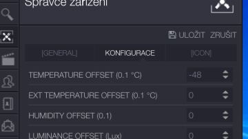

Yes, in the web control centre go to the "Internal" device settings in the device manager (it is under IP devices). in there you have the configuration. 1st option temperature offset. You would offset is in negative values...

Firstly the increments are 0.1 so for -1Degree you need to use value -10. After that you need to click on set configuration, then save. Dont forget to synchronize and refresh the web browser.
I just tried and it does work. It might need the temperature sensor to do another reading before the correct value shows up.

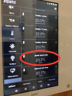

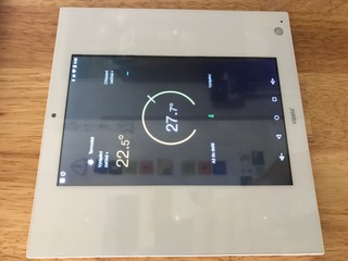

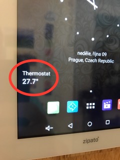

I have another problem, value of internal temperature sensor is high, so i change offset for correct value. Now i can see right temperature in Temperature sensors BUT the temperature in Thermostat and on the home screen of zipatile is original.
I think this is BUG, am i right?
