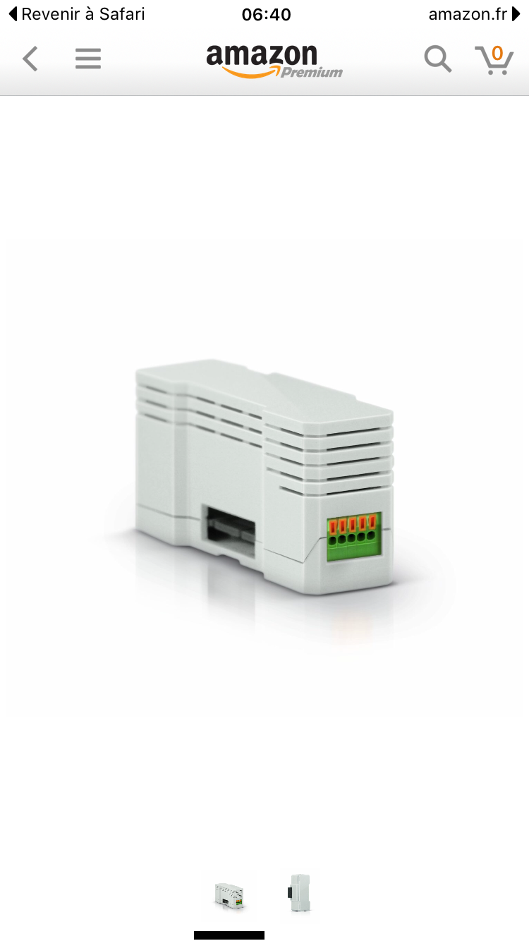

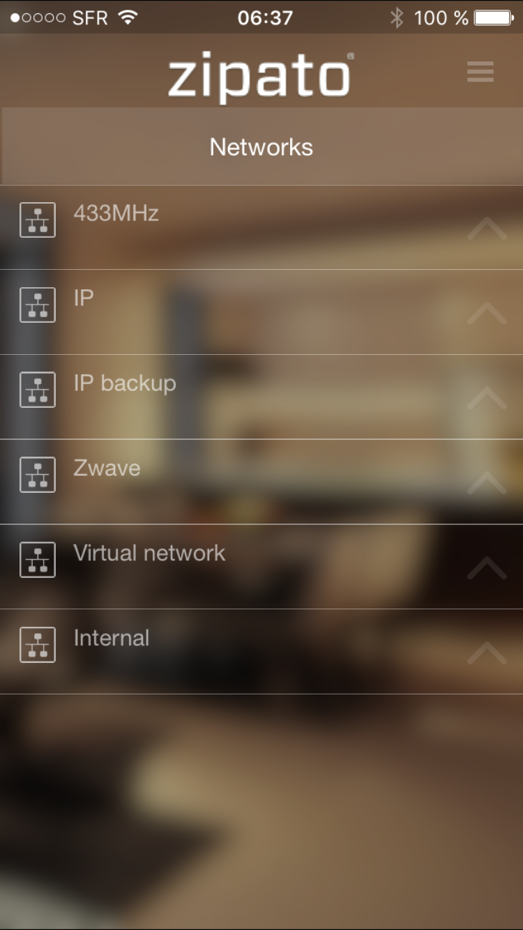

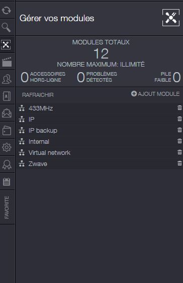

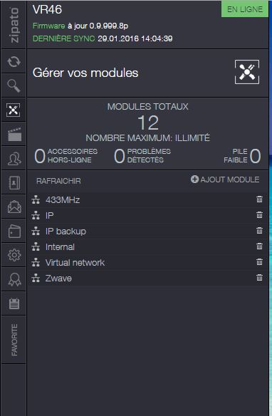

i have a problem with the serial module i had just installed yesterday after try too change slot and many synchronization i can't find it in the dashboard of extension ...
Anybody as the same problem is there a solution .? the module is out ???

make sure the module is connected to your Box and please upgrade your Box to the new beta firmware. To do this go to Controller settings -> Firmware select beta firmware -> LOAD and type YES. After you get a steady green LED indication on your Box the upgrade is completed and the module should be working correctly. It will not be represented in Device manager but you will be able to join a device connected on the Serial module, for example Paradox.
