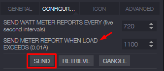

Hi Andy,
As I already mention, you need to click on the parameter name so additional buttons can show up.
/7ce03adf1782dcc11082880c95b0b677
Kind regards!

Hi Andy,
You need to click on the parameter name so additional buttons can show up. After you select the value, press SEND. After the configuration is successfully sent, Save and Sync.
Kind regards!

Hi Andy,
Kind regards!
