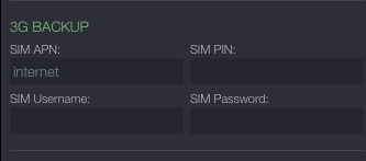

- Same settings as from the iPhone have been added to Zipabox Settings -> 3G backup

I have attached my 3G Backup settings....
instead of internet, put telenor as APN name. leave rest of fields blank.
Hi Darkwing,
Thanx, i did already try that APN name, no luck...
That APN is now only in use for MMS.
With that APN - "the cycle" i described does not start,
Telenor APN is: services.telenor.se
