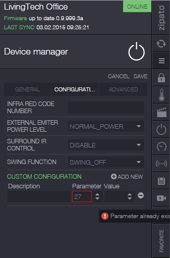

You cannot add custom configuration for parameters that already exist in the configuration tab.
Parameter 27 is named INFRARED CODE NUMBER in the ZXT-120 configuration tab.
From the device manager, select Z-wave, then your ZXT-120 should appear.
Behind the name, you'll se an "settings" icon, click on that, and then select the configuration tab - there you can send the 27 parameter :)
Dear Bjorn,
this is what i got when i put parameter 27 , also as shown in the pic there is an IR code field, is this where i put parameter 27 ? or its the place where i put the IR code for the AC ?
Note: i tried both (to put parameter 27 and IR code for AC in the IR code field and both not working).
thanks
Dear Bjorn,
thanks
