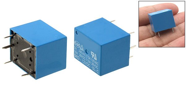

You can use external power supply to power the siren and a NC contact of a 12 volt relay between bell+ and bell- that cut's off the trip line.

Thanks! I did some research and suspect it is not a siren but just an extension speaker and that the old alarm could send a siren tone. The other siren I have is a Securitas SEC 01 and it use max 30mA current.
However, I have a lead battery connected and also a spare external double relay so I might use the circuit you proposed if needed to connect two sirens.
