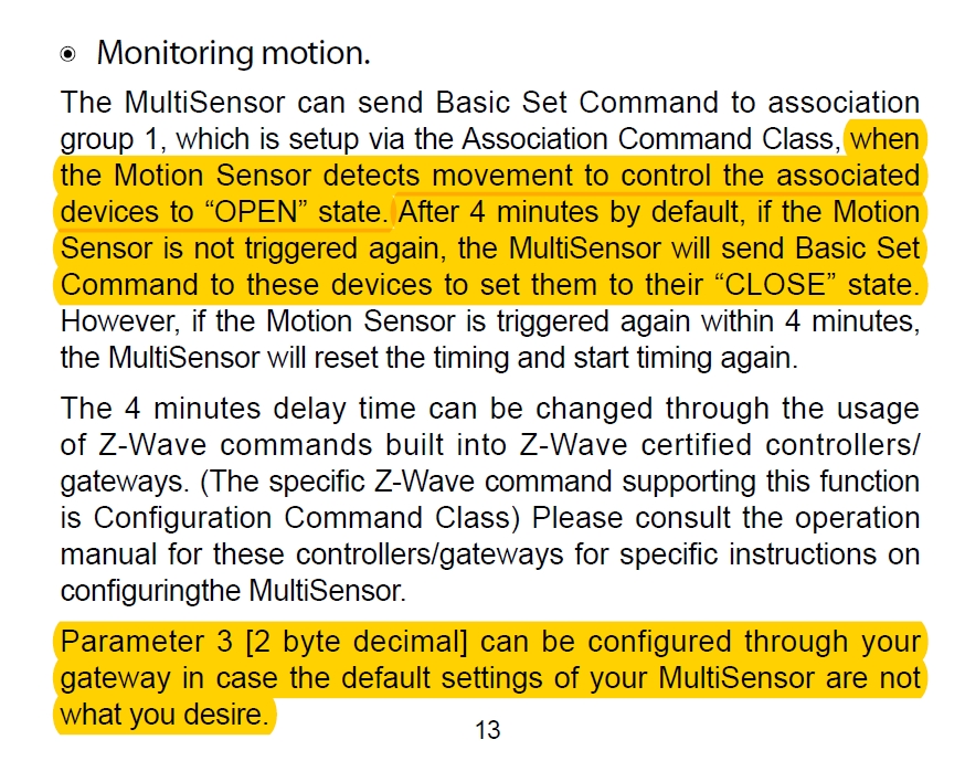

Looks like accidentally your MS6 got configured with a basic set direct association, which can be done through any zwave controller in order to allow your device to control directly other device on the same network without the need of the controller. This is a completely different process that need to be done after you included successfully your device to the controller's network. Inclusion process only writes network, node id and master node id to your device, and on the controller side it updates routing table, as far as I know basic set configurations are optional, maybe you experienced a very weird bug...

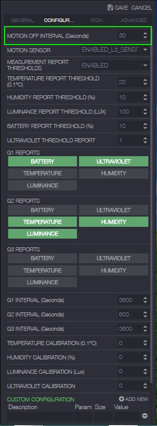

I have a question related to this issue somehow. How can I set up Multisensor 6 settings (basically it's about motion sensor interval)? I have found information in old topic - https://community.zipato.com/topic/problems-with-aeon-multi-sensor#comment-62 but it looks like this was based on old GUI version.
I'am a newbie so sorry for a dumb question.
MTDS,
Please look at the attached screenshot, that is the parameter you want to change. If you increase this number your sensor will delay more time to send the "NO MOTION" message to the controller, during this time it will stay on "MOTION" state and will not detect more motions in that period of time, some call this configuration "blind time".
Maybe this is the problem while adding the sensor and triggering lights?? Found this while reading Aeotec MS6 manual, maybe Zipato is setting this function by default to the closest neighbours of the sensor, I assume it is detecting MOTION and that is why it turns ON/OFF the devices.
