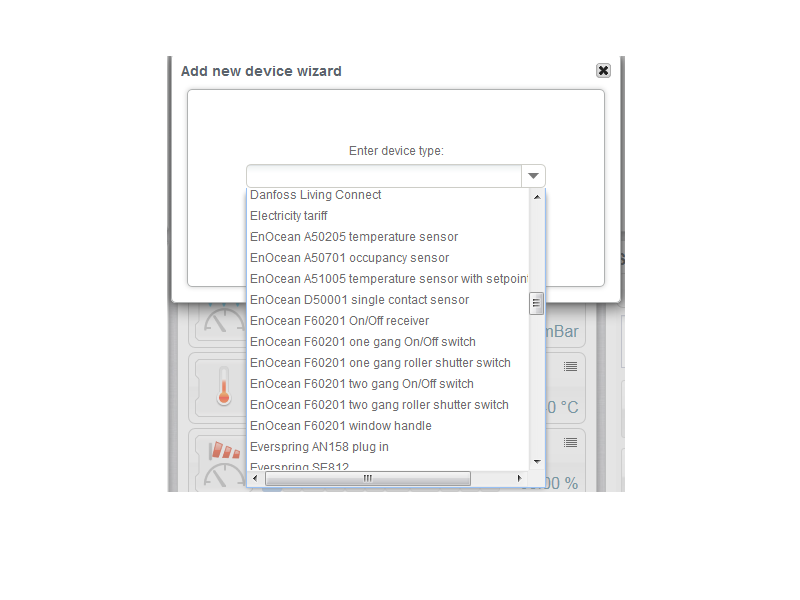

Hey there,
What are the EnOcean endpoints compatible with the Zipabox please ?
Hey there,
Hi there,
In the attached file you will see the endpoints you can select in the control panel.
Hi there,

Greetings,
The list shows enocean equipment profiles we currently support. Every enocean device has to implement a certain enocean equipment profile. A full list of profiles is listed in the following document:
http://www.enocean-alliance.org/eep/

Any device that implements an enocean equipment profile that we support. Each enocean device implements, or should i say conforms, to a single enocean equipment profile.
For instance, we have support for the D50001 enocean equipment profile. That means that we support _every_ enocean device that implements this profile.
And even if you have a device that uses an EEP that we don't currently support, we can write support for the EEP very quickly.
