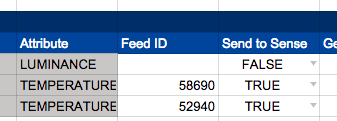

Hi Lars,
Don't forget to put your feed ID in the corresponding column, as you can see in my screenshot.
Please remove spaces, dot or special characters.
Hello Nicolas,
i don't really no what to do whit the feed ID, can you explain this to me.
do i have to add meter to the sen.se board and use the meter ID in the feed ID something like that?
Hi Lars,
You need to create a device in open.sen.se, then a feed (for example I have a feed for bedroom temperature and a feed for living room temperature). For each feed, you will have a feedID, that you will have to put in front of the device in the spreadsheet.
