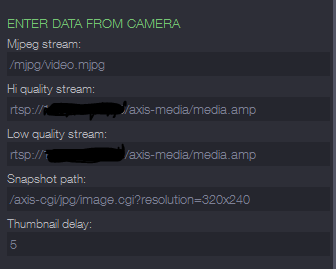

Andreas,
Could you please post a snip/screencapture of your camera settings from Zipabox Dashboard (blank out IP address) and specify which camera they are for, see my enclosed example.
Brgds Robert

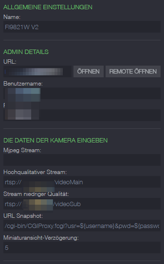

Here it is.
Thanks Andreas!
