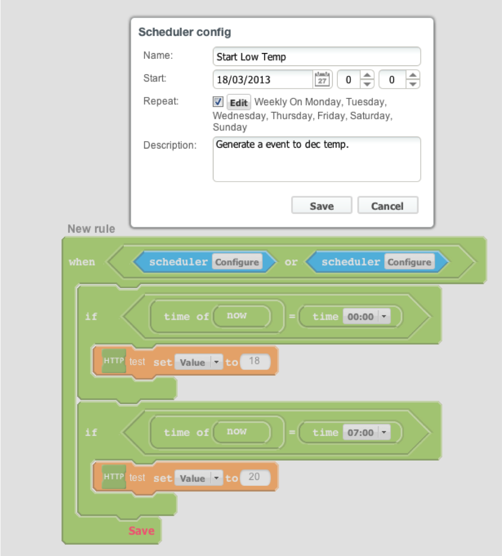

A schedular rule can look like this...
if you make sure to sync the schedular-event-time with the if-time, you can have all in one rule...
