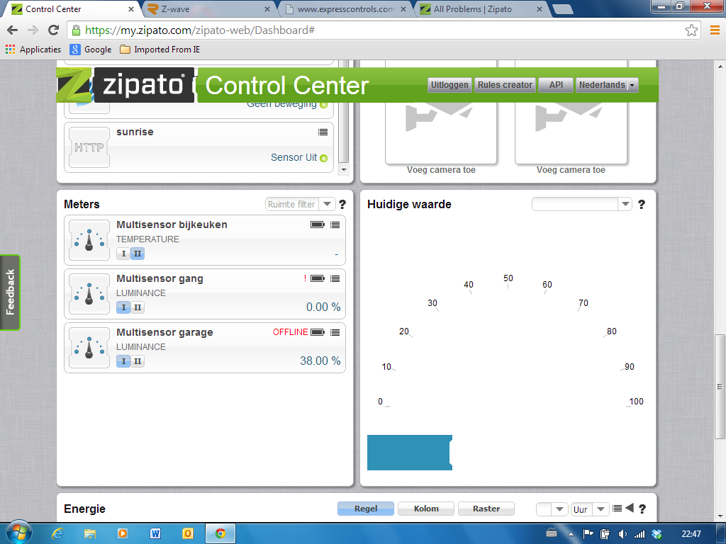

Today i have include a EZMotion+ sensor. Motion and the illuminate sensor works fine but there is no temperature, see also attached file. What is wrong. Three devices has the same problem.
No temperature...
maybe you could show us the Zipato config screen for the device?
Maybe parameter 8, bit 0 is set to 1? (documentation)

Here is the screenshot. I have no changes yet. It is the standard config after include the sensor. I only select room and type sensor to 'general sensor sensor'
The problem is now change after a push on the blue button and after a new sync from the config window. Now i have temperature instead of illuminance.

Press "Synchronize" on your dashboard if you haven't already done so. Then try to manually wake up your device. The luminance and temperature measurements should now appear in your event log.

Thanks for the answer. When I manually wake up the device he gives temperature en luminance. The luminance value is not the right value. (4% with daylight) The interval frequency for wake up i have configured at 30 minutes. The device must then every 30 minutes gives new values of the temperature and luminance but that isn't happening. The device gives only values after a manually wake up and then it is quiet.
I have press after every change te 'synchronize' button.
