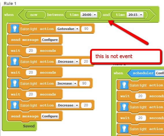

I tried for 2 days to run the Rules, but nothing works.
attachment, two examples that do not work.

Ok Sebastien, you made a two rules. Neither one is working because your first rule is wrong (see explanation below and picture attached) so the new program could not be compiled and old one stays active. This is why you think nothing is working.
Regarding the rule mistake, your rule look like this:
WHEN now between "time 20:00" and "time 20:15"
so there is no trigger event and rule can't be created, nor the program.
This rule should use scheduler:
WHEN scheduler (configure to 20:00)
There is a rule checker which we made recently and it will be released soon. It won't allow you to save wrong rules any more.
Be free to contact us if there are any further problems...

thank for your quick answer.
now scheduler run !
but, as you can see in attachment, only 1 action on 3 run in the rule.
do you have an idea about that ?

Increase and decrease are not the same as gotovalue and in your Rule you expected light to go on 100% and 0%, for that you should use action Gotovalue.
