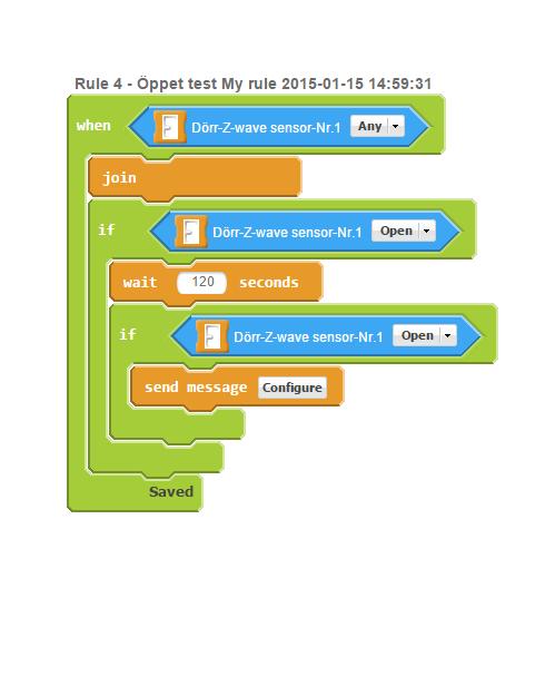

I am wondering how I can send a message, if a door is open for more than 10 minutes. Of course I could trigger a rule when the door opens, then wait ten minutes, then check if door is still open and if so, send a message. But that could trigger false alarms in case the door is closed but AGAIN opened 10 minutes after the initial open.
If the repeat function would still be there I knew how to do it (check every 5 secs for door closed and stop the rule if door closed). But without repeat I do not get it.
Many thanks for any suggestions!
I think that JOIN should do the trick.
So the rule looks like:
-JOIN
-WAIT 10 minutes
-IF.. etc.
The join statement kills any execution of the same rule. SO no false alarm is triggered.
-JOIN
-WAIT 10 minutes
-IF.. etc.
I am using this rule:
Not sure about the fact that there could be false detection, I never tried this kind and situation and never got any false detection.
It works perfectly!
It works perfectly!
