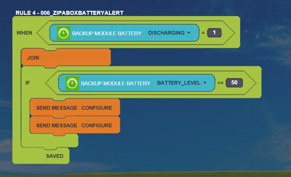

For instance, I have the backup module, and I see there is a Battery_Status attribute, which I would like to use to create a rule for the Zipabox to push me a message to let me know when the power is out (Discharging vs charging) however, there doesnt seem to be anything I can associate this to (sensor or meter).

Regarding the backup module I have the same scenario, cannot test the rule for now but it is a start;

Alberto - thanks a lot for the links, I really appreciate it. The only attribute that seems available is battery level (which is actually Battery Status, and not matching the options) So it is possible to see that the battery is charging or discharging, (power out) but not able to identify when the power is restored, since the status I'm looking for is Normal, but you would need to setup a rule to know when the status (%) is going back up.
