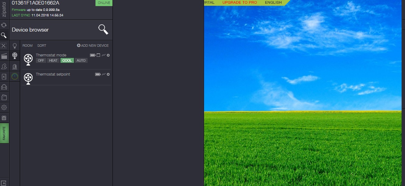

i have some question about the remotec zxt-120 thermostat and the zipabox
we have been using the Remotec ZXT-120, i have included in the network with no problem
however i am not able to change the thermostat setmode, i do not see the temperature bar in the web interface or the phone app.
we have a zipamini here as well and i have tryed the same, in the zipamini i am able to see the temperature bar, but still i am not able to see the way to change the temperature in the phone app
any idea on how to solve this?
Remotec FW is 1.2
and zipabox FW is 0.9.999.8a
            print screen zi...
