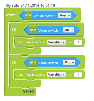

What i really want is to use a virtual switch to set a variable to 1 if virtual swith goes on and set it to 0 if the virtual switch goes off
and with that i will have a semaphore to do or not to do rules.

Hello Jose,
I have created the Rule you asked for and I attached it to this message.

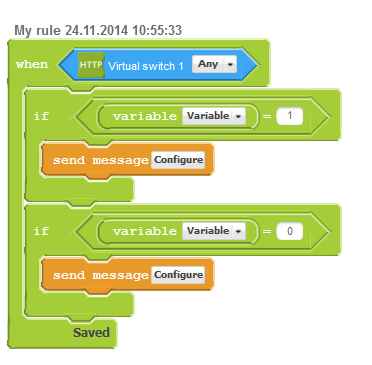

I have also created another Rule to send me an email when I change Variable to 0 or 1, to test my first Rule.

Hello Jose,
