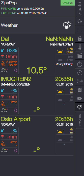

I'm trying to add a couple of places. The place/town shows up (after a couple of attempts) but not the other stations? Isn't stations supported?
http://www.wunderground.com/cgi-bin/findweather/hdfForecast?query=60.233%2C11.168&sp=IMOGREIN2
Airport Gardermoen
http://www.wunderground.com/weather-forecast/zmw:00000.1.01384
regards
After some time it showed up right and works. I think the first update from the server where wrong.
