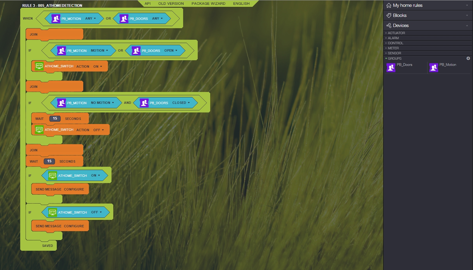

I'm trying to create a rule that will detect if someone is at Home or away and then set a virtual switch accordingly. This is so I can send me a push notification reminding me to arm my security system if I'm away. As of now I'm still debugging it as it doesn't appear to be working (virtual switch does not change state). Can someone see any problem in my rule? I have created two groups of sensors, Doors and Motion sensors which I'm using to set or reset the switch.

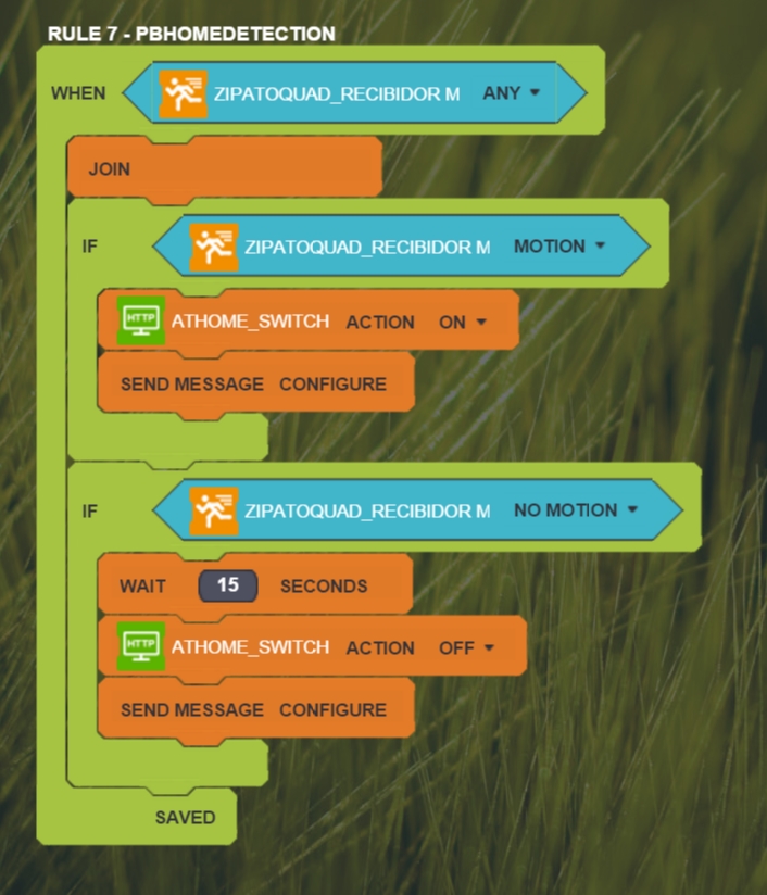

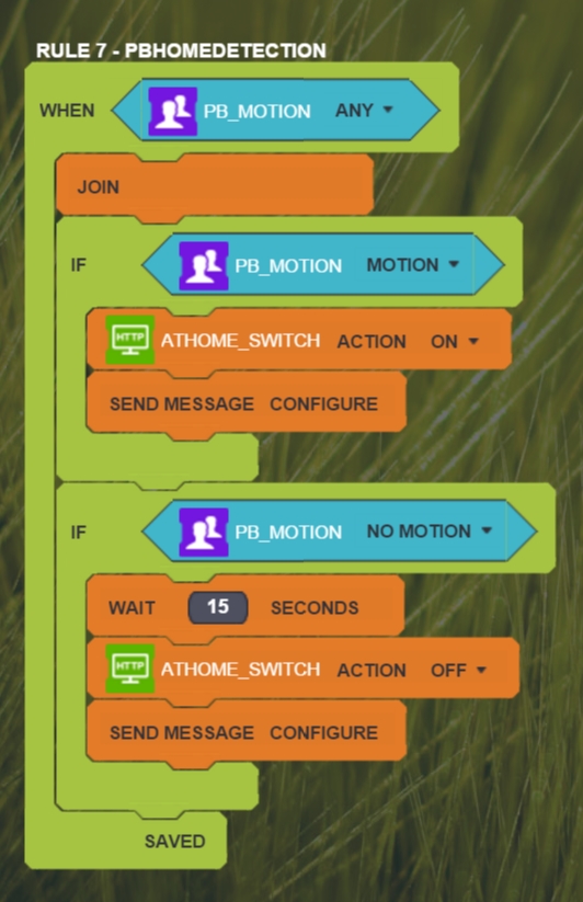

I definitely think the problem is the groups of sensors. I have tried something very simple like the first image and it does turns on/off the switch whereas the second image does not work at all. I guess I would have to open a ticket...

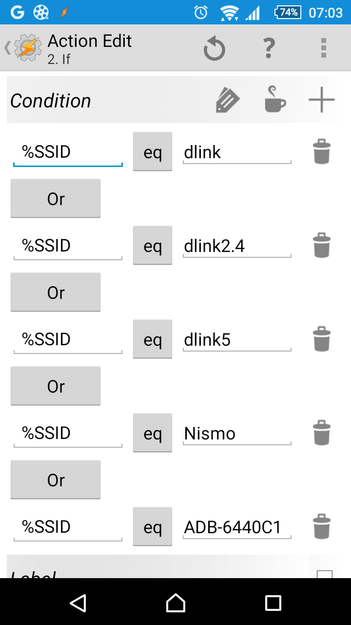

Hi Alberto, this is one of the posts where it is explained https://community.zipato.com/topic/https-sensor-with-tasker
AMD this is the second topic. In here Nicolas has different approach. His version is one rule that simply repeat as long as the Tasker dies receive a response from Zipato https://community.zipato.com/topic/tasker-examples
And in here you should find my Tasker profile how the rule is set up. https://community.zipato.com/topic/test-of-virtual-switch-state-failing
As to my latest post, the screenshots you find there is for the recurring task. In that I attach the printscreen here how the if rule is looking
