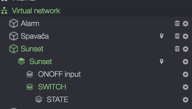

Well, im not sure how this can be done without using virtual devices. Virtual switch would not help anyway, you would need to use vitrual sensor as that has a direct http link where you only need to insert the status 1 or 0 manually at the end.
