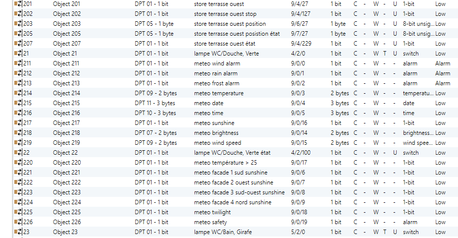

Very interesting, can you please attach an ETS printscreen? I've attached my config, if you see something wrong... Thanks!

Thank for the update... I think its normal, as I see for the flags, because you read it from Weather Station and write it to KNX BAOS to push to Zipato.

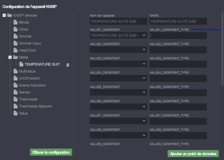

Also, what "KNXIP devices" are you using (Meter, Multivalue or Value??) and what do you put in Value Datapoint Type in Zipato?

I forgot to add, I use KNXIP, and not a Zipato KNX extension module.

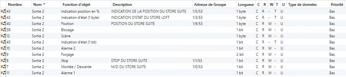

And blinds are working perfectly, the status of position and setting of % is working great.
Thank you!
For the blinds, I use KNXIP blinds module. I'm able to slide to setup % of opening, and if I change it from KNX, it updates it correctly to Zipato.
I don't use slats, so i don't need short press. Also, I've had to migrate my KNX old Hager TS223 / TS224 modules to Hager TXA223 with TXA223 - a2 program to get the position % reporting.
