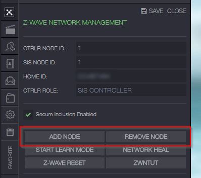

After several (20 or more) unsuccessful attempts to reinclude my nodon wall switch again, yesterday suddenly I had luck.
What I did directly before:
- I've deleted all rules where the switch was involved from former inclusion
- I've used functions REMOVE NODE and ADD NODE in Z-Wave-Network-Settings and after that the normal include function again.
--> After that my nodon switch was successfully included again

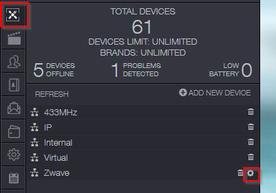

you'll find these settings when you open Device Manager and click on the small gearwheel behind Zwave (see my screenshots).
Hope that helps.

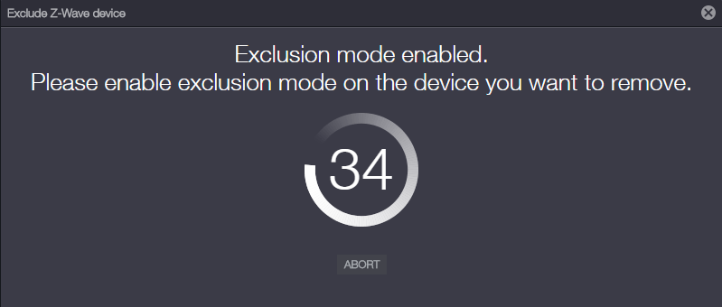

Don't worry... after pressing Remove Node a popup will appear (see screenshot) where you can exclude a single Z-wave device... not the whole Z-Wave node (all devices).
