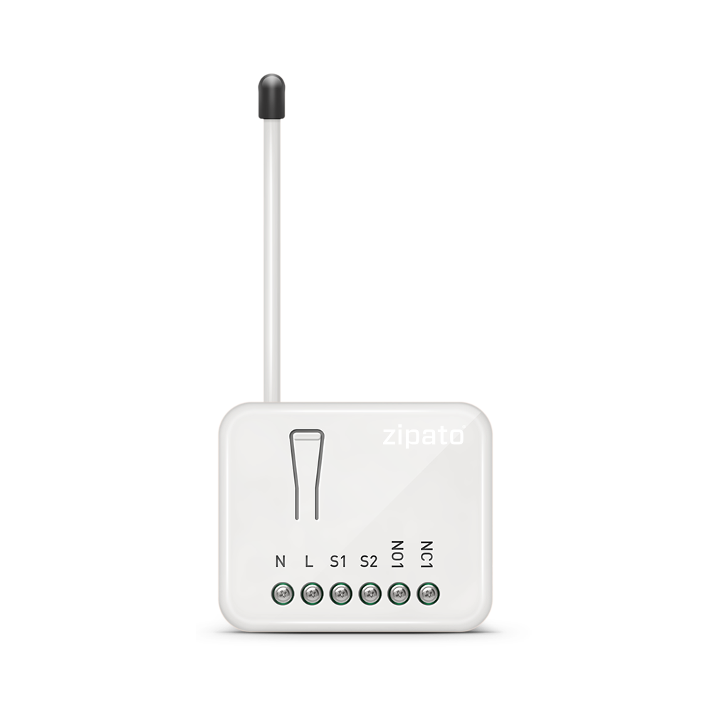

MM Motor Controller - LED light work fine, but can not control it
Cause of Failure:
- No association setting
- Same frequency interference
- S1 or S2 are pressed in Two Push Button switch type
- Micro Module does not accept RF command
Recommendation:
- Carry out association
- Wait for a while to retry
- Release S1 and S2
