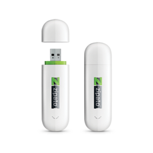

1. Connect 3G stick to USB port of the Zipato Security Module, Backup Module or Serial Module
2. Log in Zipato “Control Center”
3. Click on “Zipabox settings” on the left sidebar
4. Fill in 3G Backup fields in "Zipabox settings"
5. Save everything
6. Synchronize changes by pressing the“Synchronize” button on the left sidebar
