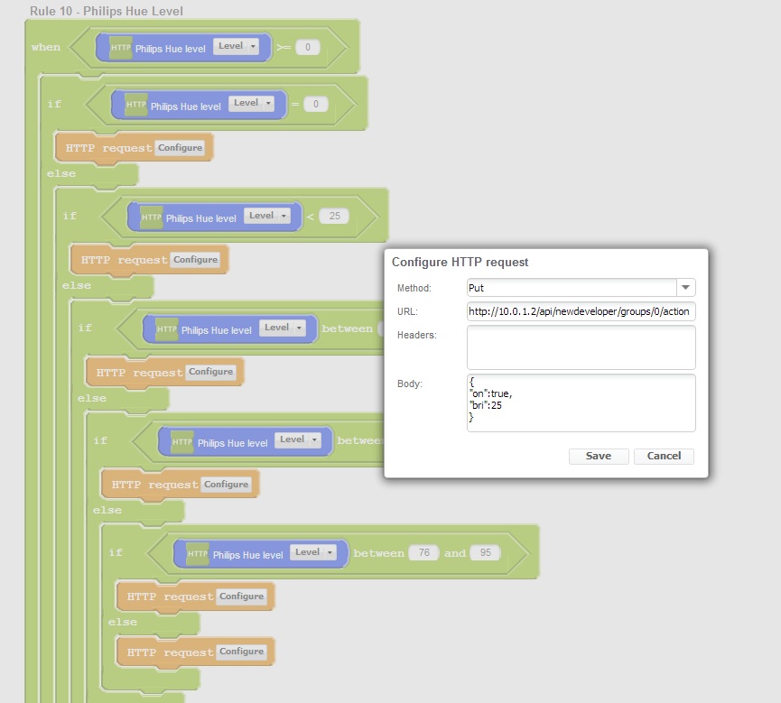

guys, theres no need of a server. The "circle" box hs already a server inside. The only need is that the light and the zipabox are in the same network (and you should enable the developer user following the guide here http://developers.meethue.com/index.html )
attached a screen of a simple rules to increase/decrease the light.

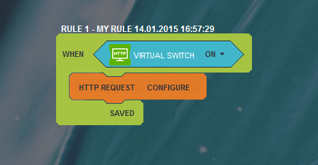

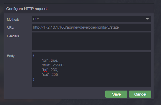

will be supported within a two weeks. Meanwhile, you can use http request puzzle within a rule creator
please see the attachments, how the rule, and configuration in our system how you can use HTTP Request and some virtual, or real switch to control Philips Hue.
The example provided here will allow you to turn the 3rd bulb in the hue bridge that is located on the given IP, and is being controlled with newdeveloper user on the bridge.
/api/newdeveloper/lights/3/state
/api/{user on bridge}/ligths/{bulb name}/state
the bulb will have the following settings what can be seen from json:
hue value of 25500
brightness value of 200
and saturation value of 255
parameter "on" can be true for bulb on, and false for bulb off
json in body of http:
"on": true,
"hue": 25500,
"bri": 200,
"sat": 255

It's really easy to use Hue without special support. You can find my example rule here.

I also would love to see the option to add the white colors to the color (RGB) selection.
Edit: I made a rule where the brightness of the light is checked. If the brightness is 0 send an http post to the hue bridge (/api/{user}/lights/{id}/state with value {"on":false"}).
And maybe an idea (stolen from the hue app) make the sliders under Device Browser -> RGB bulb the current color of the light. :)

I got it to work like this:
1. You need to get the units
random generated username, this you can get like this:
è http://<bridge
ip address>/debug/clip.html
è Put in url in the box
/api
è In message body put in {"devicetype":"my_hue_app#iphone
zipato123"} and press PUT “Rememeber to push the Phillips Hue Bridge just
before pressing put”
This will generate a encrypted
username to use in a HTTP request like this:
Success “username” 1028d66426293e821ecfd9ef1a0731df (Take what ever it generates here)
The HTTP request in my Zipato rule looks like this to turn on my lamp:
Method: PUT
URL: http://Brige_IP/api/1028d66426293e821ecfd9ef1a0731df/lights/1/state
BODY:
"on": true,
"hue": 25500,
"bri": 200,
"sat": 255
The lights names 1 to XX
you can find on your HUE mobile app etc.
è http://<bridge
/api
Method: PUT
BODY:
"on": true,
"hue": 25500,
"bri": 200,
"sat": 255
