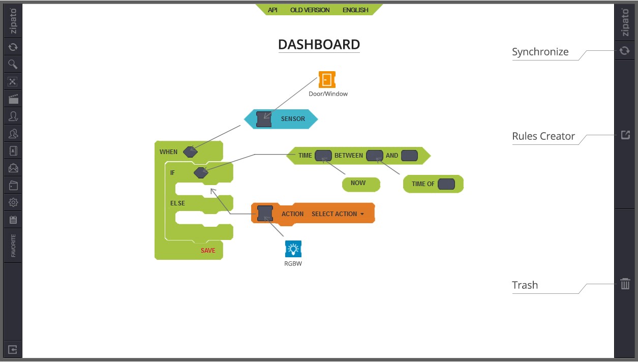

Rules are created by dragging blocks onto the central Dashboard and combining them with devices and other blocks. By doing this you can easily build a complex rule to control your home automation system.
Each Block has a specific function, and importantly, the shape of the block helps you to understand how it should be used with other blocks.
As you can see from picture, each block has a shape and can only slot into the same shape 'hole' of another block.
When your desired rule is created you need to click on "Save" (red letters on WHEN block). After saving the rule it is required to do a Synchronization via Synchronize button in order to compile a rules script and download it to the Zipabox from Zipato Cloud Server. When the synchronization finishes, your rule will show up in the Rules Creator section under "My Home Rules" tab.
