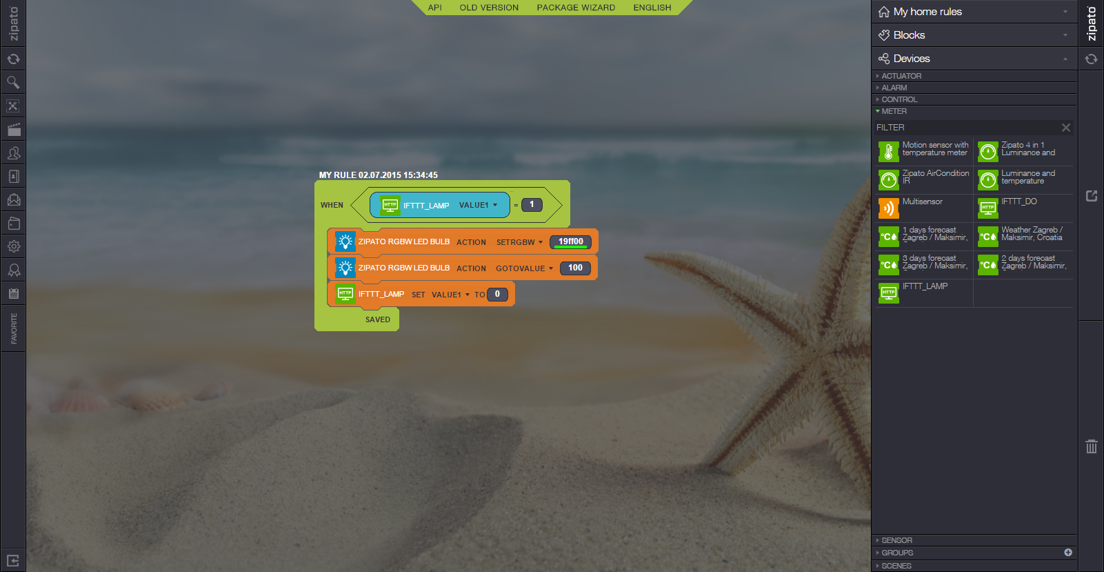

Then we created the following rule in the Zipato Rules Creator to control a virtual meter. For more details see the "Introduction of Rules Creator" section.
Important
You will need the URL of 'VALUE1' of your virtual meter. The URL can be find in the settings of the attribute 'VALUE1' in the device browser. You can transfer it to your smartphone via an e-mail to yourself or a text file in dropbox for example.
This rule works as follows:
1. Main 'When' block wraps the whole rule. The rule is activated when 'VALUE1' of virtual meter 'IFTTT_LAMP' is equal to 1.
2. The first 'Action' block turns on the Zipato RGBW Light Bulb to green
3. The second 'Action' block turns on the bulb's intensity to 100%.
4. The 'Set' block put 'VALUE1' back to 0.
5. Don't forget to 'Save' your rule and then to 'Synchronize' it at the end.
