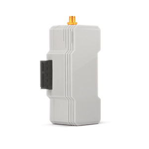

Zipabox 433MHz Module - Connecting and installing
Zipabox 433MHz Module is used for paring of Zipabox with the devices that communicate on 433MHz Radio Frequency spectrum range. 433Mhz spectrum range is traditionally being used by many simple and cost effective wireless devices. Those protocols are being implemented in some of the most popular automation and security product ranges in the world (Nexa, CoCo, Chacon, Somfy RTS, X10, Oregon Scientific, LightWaveRF, Vision…). Long range and high reliability makes such products as the perfect choice for the cost effective security and automation applications where two-way communication is not needed.

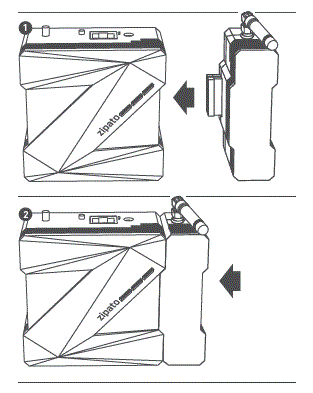

Connecting the 433MHz Module:
1. Disconnect Zipabox from power supply
2. Align connector of Zipato 433 Expansion Module to expansion Slot 2 of Zipabox (or to the module connected into Slot 2)
3. Join module and Zipabox together until gap between them is completely closed.
4. Connect Zipabox to power supply
Notice: This device is meant for mounting only with Zipabox. 433MHz Module must always be installed in expansion slot 2 of Zipabox. If you have other module already connected onto slot 2, you can connect 433MHz module on it. Other modules can be attached to 433MHz module.
