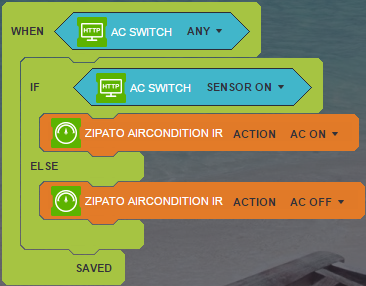

1. In 'Device Manager', click on 'Add new device' and add a virtual switch 'AC Switch'
2. Go into the configuration menu of the Virtual Thermostat PRO
3. In 'Devices', select 'AC Switch' as an output for Cooling. Don't forget to save.
Create the following rule, don't forget to save and synchronize
