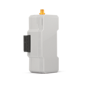

Zipabox ZigBee Module allows Zipabox to communicate with all ZigBee enabled devices and integrate them into one unified home automation network. By adding ZigBee network capability to ZipaBox user can connect any ZigBee HA compatible device and combine them with all existing devices in his network regardless of protocol. Allows connecting additional 65535 devices, supports mesh technology and two way communication between devices and a controller.

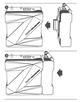

Connecting the ZigBee Module:
1. Disconnect Zipabox from power supply
2. Align connector of Zipato ZigBee Expansion Module to expansion Slot 2 of Zipabox (or to the module connected into Slot 2)
3. Join module and Zipabox together until gap between them is completely closed.
4. Connect Zipabox to power supply
Notice: This device is meant for mounting only with Zipabox. ZigBee Module must always be installed in expansion slot 2 of Zipabox. If you have other module already connected onto slot 2, you can connect ZigBee Module on it. Other modules can be attached to ZigBee Module.
