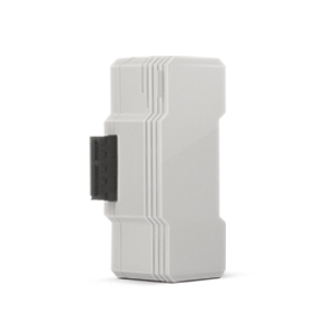

Zipabox P1 Module - Installing and configuring DSMR Electricity Meter
Requirement:
- You need to have P1 Module installed on your Zipabox (please see connecting and installing article)
- Electricity Meter needs to be connected onto the Zipabox P1 Module
