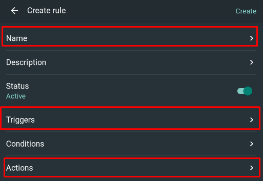

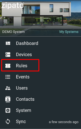

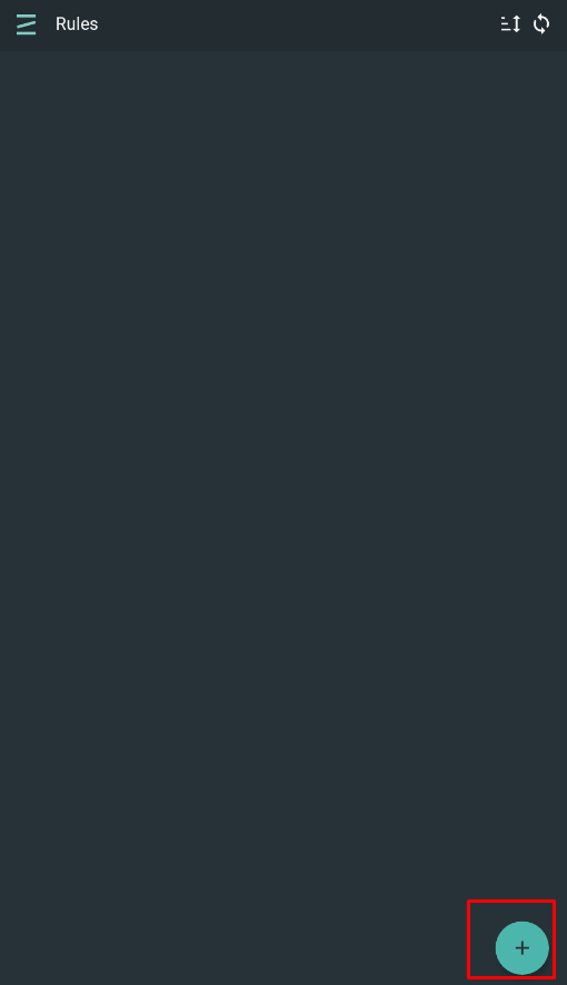

1. Select "Rules" from the main menu
2. Click the "+" icon in the lower right corner
3. Define Rule Name, Description (optional), Triggers, Conditions (optional) and Actions
3a. Rule name is the title of the rule so use a unique name to distinguish each rule

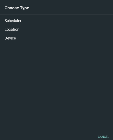

3b. Rule triggers are events which will trigger the rule. Add a trigger by clicking on the "+" icon and selecting the trigger type
Scheduler - Defines the time when the rule will be triggerred. It can be repeated minutely/ hourly/ weekly/ montly/ yearly.
Location - Uses the geofencing feature to define the location area (defined by radius) and user who will trigger the rule by arriving or leaving that area
Device - Defines the device (virtual or physical) which will trigger the rule by changing its state or value.
NOTE: It is possible to define several triggers with any type

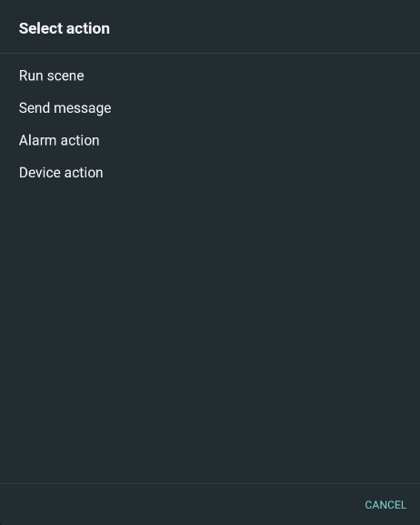

3d. Rule actions define actions which wil be executed when the rule is triggered
Run scene - Selected scene will be executed
Send message - When the rule is triggerred, message (email/ SMS/ Push/ Voice/ Local voice/ Local text) will be sent to the selected contact
Alarm action - Executes the selected alarm action. Only alarms that have the "quick arm" option enabled can be used in the rules
Device action - State and/or value of the selected device(s) will be updated when the rule is triggered.
NOTE: It is possible to define several actions with any type

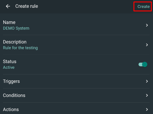

4. Click the create button

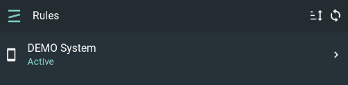

5. Created rule is visible in the rules menu
NOTE: When a rule is created or edited performing synchronization is mandatory.
