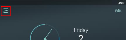

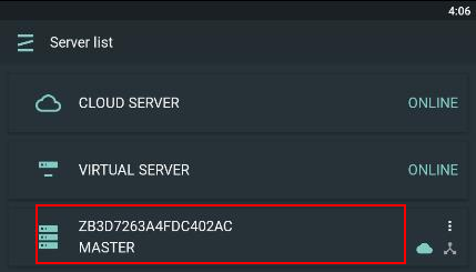

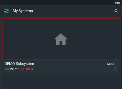

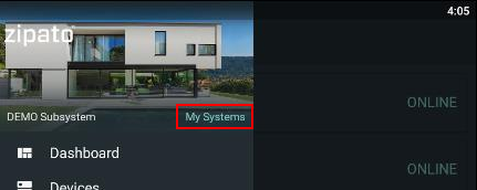

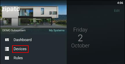

1. Select a system
2. Select the respective server - Master or Slave server

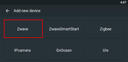

3. Click the "+" icon to start device inclusion

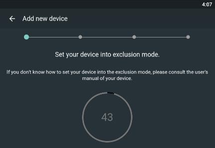

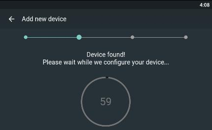

5. At this screen put your device into exclusion mode.

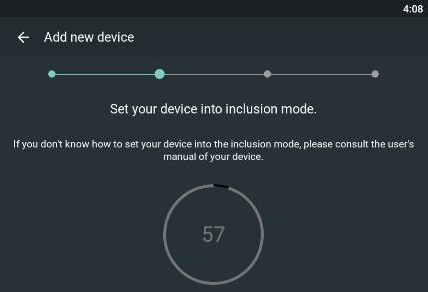

6. At this screen put device into inclusion mode.
NOTE: Some devices require an input of a PIN code during the inclusion so additional pop-up window may appear.

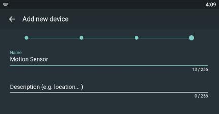

7. Define name for your device. Description is optional.
NOTE: If the name is not specified, "No Name" will be used by default.

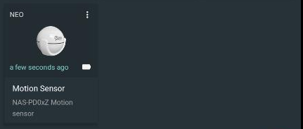

8. Save changes.
9. After the procedure is done device will be visible in app.
