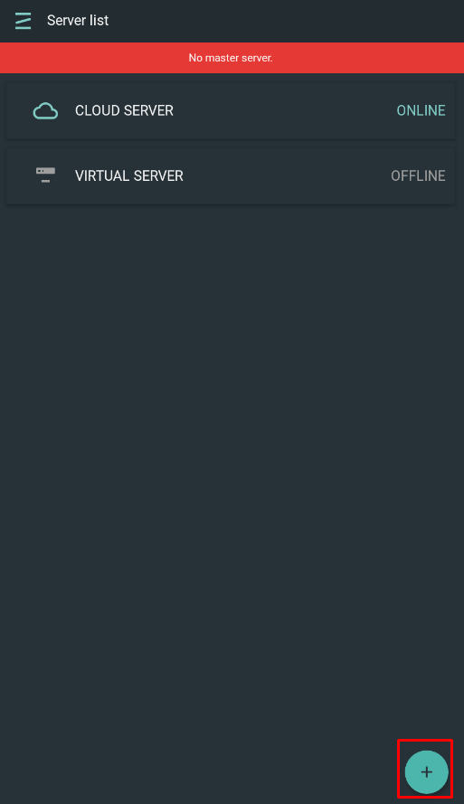

1. Select your System by clicking on its widget under the My System screen
2. Select Devices from the main menu
3. Click Add icon at the lower right corner

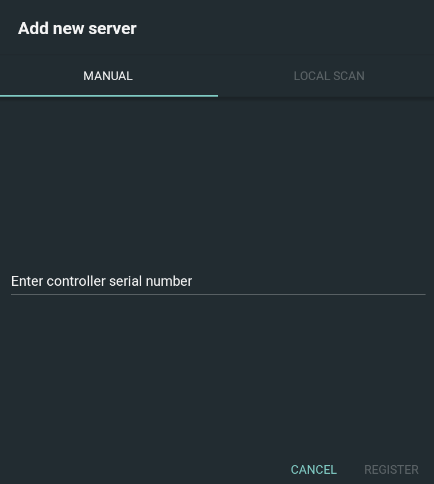

4. Select Server icon
5. Enter controller serial number

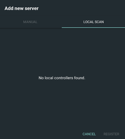

5a. Under Local Scan tab, all Zipato controllers which are in the same network will be shown
6. New server is added

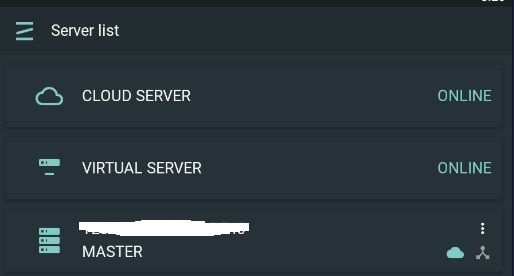

There are two types of server - Master and Slave.
Master server: Firstly added server and it is required for the functionality of the System. Eash System must have Master server which is a host server fot the virtual server of the System.
Slave server: Multiserver license is requried which enabled up to 5 servers in the System. Slave server must be in the same network with the Master server in order to enable rules with its devices.
