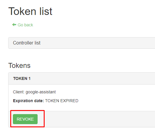

If user has a problem to connect from google home to his/ her Zipato system, reseting of token is required.
1. Open https://auth3.zipato.com/login.jsp
2. Specify user credentials - account and password and Sign in
3. Click on Tokens green button
4. Click Revoke green button to reset token
