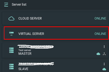

2. Open Virtual Server card under Server list:

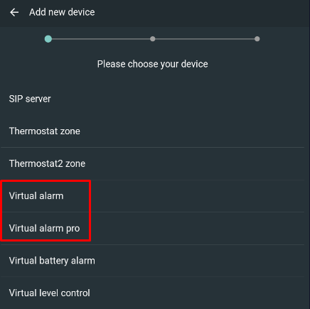

4. Select "Virtual alarm/ Virtual alarm pro" under adding virtual device selection menu:

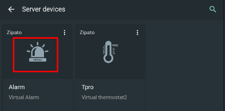

5. Open Alarm device screen
6. Open alarm settings menu and select Configuration

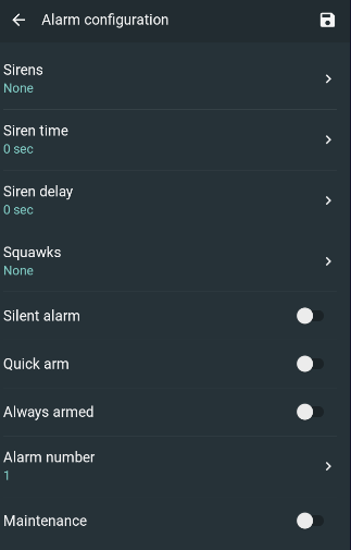

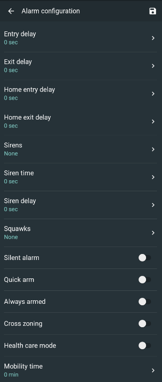

6A - define basic alarm parameters
6B - define alarm PRO  parameters
NOTE: See below a definition of alarm parameteers

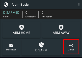

7. Click on alarm widget and Zones button in order to create alarm zones

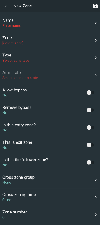

8. Click Add icon to add new alarm zone and define its parameters
NOTE: Zone's parameters are the same for basic and pro alarm partitions
