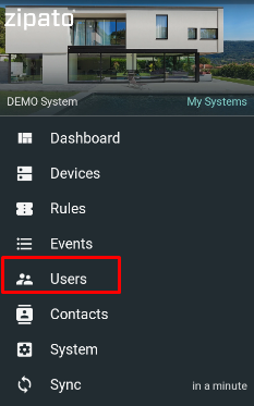

1. Select System
2. From the main menu select "Users"
3. . Click on the Add icon in the lower right corner

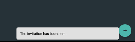

4. Input the users e-mail address (already registered on the Zipato platform or a new one)
5. Confirmation message is issued
NOTE: When invited user opens this system, user will be added to the System's user list
