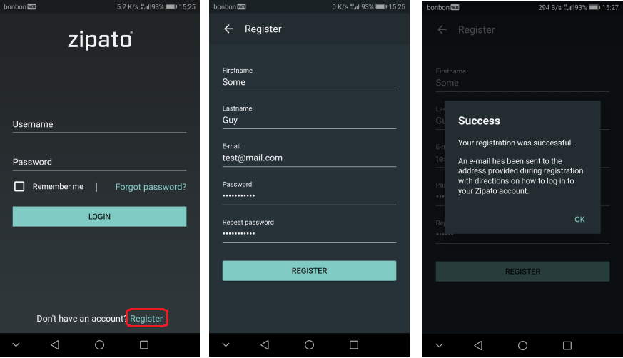

- Register an account using the Zipato Home application
2. Verify your email address
3. Login with the credentials
