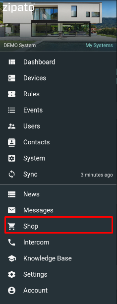

1. Open Shop menu

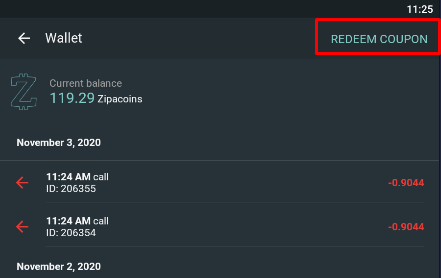

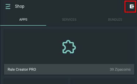

2. Click to Wallet icon at upper right corner
3. Open Redeem Coupon option at upper right corner

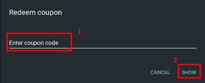

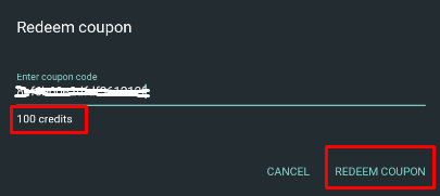

4. Enter coupon code which is received at buying Zipato Credits at https://www.zipato.com/product/zipato-credits. Press Show button to check product
5. If product description is correct, press Redeem Coupon button,

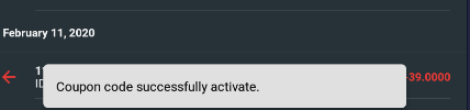

6. Confirmation message is issued at the bottom and newly added Zipacoins are added to the Current balance
